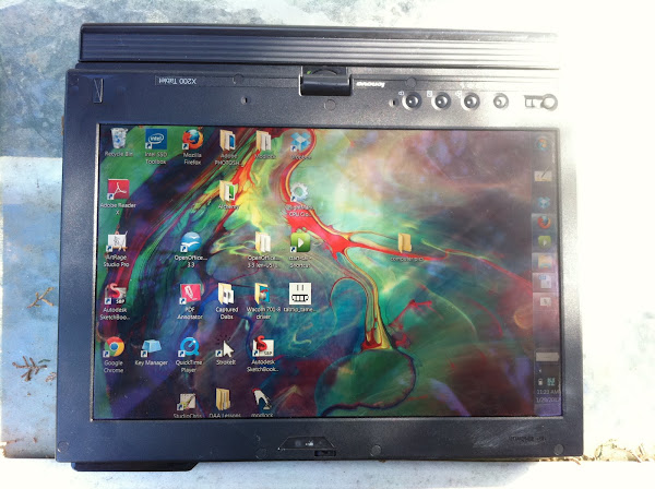

    With my x200t in the depot for so long, I recently picked up a Motion j3400 slate, supposedly the king of Outdoor Viewability. I decided to shoot some comparison pics.
    My verdict? It is also very very good. They're both good, but both different.
    The x200t is smoother, clearer, and a bit brighter (and feels a bit like writing on glass; there's almost zero friction), producing more reflections, but you can easily see through them. It's AR coating produces the shadowy "waves" of which we've spoken much in this thread. They're a bit of a nuisance, but you can move the screen to the right angle, and when you do you have a gorgeous screen that works wonderfully outdoors.
    The j3400 is sort of matte (and even has a nice bit of texture when inking), with almost no reflections at all, but lacks the sort of clarity of color and image the x200t provides for indoor work because it has a sort of "sparkly" effect. I'm assuming this is how it's own AR coating reduces reflections, by refracting light in microscopic ways, or some such thing. My understanding is that this is an affect seen in many AFFS+ screens though, so it may not come as much of a surprise to others. It reminds me a bit of my Motion le1600 in this way, just with a brighter screen and more sparklies that make it more viewable outside.
    Both screens are very very nice. Easily the two best screens I've had. The j3400 is clearly my preference for inking, the x200t for clear graphical quality. The screen on the j3400 is Gorilla Glass and is rock solid, which is very nice to write on. The x200t is some sort of semi-hardened plastic, which has a reasonable amount of give if you press with any decent pressure, which I've never really cared for.
    The clasping hinge system that the x200t uses for closing the lid has a bit of give to it too though, and I think it was adding to this problem. This means the actual body of the screen (or the black "frame", as you will) will actually have a bit of up and down movement when you want to use it as a tablet and apply force with your hand. I recently solved this by attaching a thin (1/16- 1/8") black rubber "foot" on one of the outside corners of the back of the screen. This helps create a more consistent experience of pressure between the back of the lid and the body of the hand rest when the computer is used as a tablet. As such, there's less movement from the screen, and this has made the inking experience better on the x200t. Still, even so, the plastic of the screen has a bit of give, and isn't as "solid" as the feeling of the j3400. It's better though, and much improved. It had been one of my complaints about the x200t as a tablet, and this solution may have improved it enough to be considered a solution to me.
    Of course, the j3400 doesn't have this issue about "give" in the screen at all. I also have to say that I prefer a bit of tooth when inking, and might be adding a mild Anti-glare screen protector to the x200t to improve that experience. Of course, that'll probably create some noise, and it'll probably also slightly reduce the outdoor viewability on the x200t. And that may take away that "crystal clear" color experience you get on it comparative to the j3400. As such, it may be that the j3400 is the better all around screen.
    It's all about trade offs, and the major issue for the j3400 is that, regardless of how viewable the screen is outside, or how pleasantly firm or textured it is for inking, or how much I like the build or the onscreen buttons, the x200t still performs admirably in these categories (if perhaps not quite as well??), and is better, IMO, as an all around computer while still being amazingly viewable outside. It has the added benefits of being easily upgradeable, has better battery life, is slightly more powerful, and (most importantly for me) has a very good keyboard that's always available.
    I think that, for a person that really wanted an outdoor tablet/slate with a full array of ports that they could then dock at a real desktop and run their office from with a real external keyboard and mouse (not the crappy mobile keyboard that Motion offers!), the j3400 might actually be the better performer. I don't have a desktop though, and so really needed something that could be easily set up at the dinner table or at a cafe. The j3400 wasn't quite right for that usage and so doesn't seem to be a good match for me.
    Here's the pics, btw. As usual, any kind of weird moire pattern on these shots is really more about how the screen reacts to the camera. None of that is there in real life. In fact, both screens look noticeably better with the naked eye, and I have little to no problem reading either of them in the sun. Oh, and both screens are finger print magnets, IMO, but the fingerprints don't really affect either of them when really in use. Just thought I'd add that in.
    Side by side in the shade-
    Side by side, but the x200t has the 4 cell battery here-
    Side by side, comparing thickness. The x200t is 1.1-1.3", the j3400 .9"-
    x200t in partial shade on an outdoor table--
    j3400 in partial shade on an outdoor table--
    x200t in full sun, over the shoulder-
    j3400 in full sun, over the shoulder-
    Hope that was helpful for you guys and gals.
